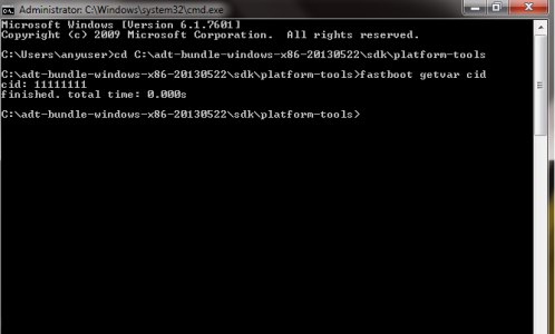

I ran motochopper again, and finally got my CID to all ones. When I got the token this time, it worked. Thanks for the help!
Good now proceed with the unlocking of the bootloader!!!! and all the other good stuff!!!

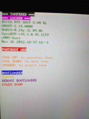

Hello!
No joy here- can't get the CID to all 1's.
Running 3.18.502.6 710RD, 4.1.1, AT&T.
Toolkit 3.0.1, W7 Pro, debug mode
I tried 2b.,motochopper several times but just I get the tampered/locked screen with no changes to CID.

Hey all. Wizzrah, if you are the one to develop this you're a badass.Tonight I took a shot at rooting, again, after the Jellybean OTA update. I rooted my one XL (USA) a year ago but did not unlock the bootloader. I did it so I could play some particular games and run Titanium Backup. Worked great and when the OTA update came out I decided to let the update overtake the root. That was fine and I continued to use my phone with limited use until I saw your post here. I decided I'd finally give in and try for the whole bootloader AND root unlock just so I can get back to where I wanted with a phone completely mine along with having 4.1.1
TL:DR My history for asking is above: My problem is here: I tried running your program today and ran into some issues. I'm getting errors after motochopper and that seems to be stopping to the CID creation (the real stuff ya know). I'm not a developer but I come from a desktop support and network admin background so please don't worry about laymens. I just am stumped at what the excutable is doing at the point of error and I'm hoping you can help me. Feel free to talk to me about it if you have more questions about my setup. The laptop I'm using to connect is Win7Pro64 and a work laptop but I'm a local admin and I made sure to run the program as admin. The file is saved with no spaces as you indicated. That's all I have right now. Thank you.
So the step that I was expecting in that second picture is to see the CID but I guess the errors are keeping something from writing to the phone. My drivers are working because HTC Sync is showing my files on the PC, in case that would come up.
-Chris

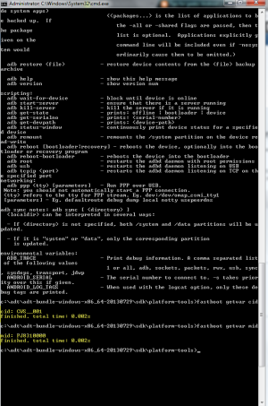

Hey Wizzrah,
Thanks for the assist. I did as you asked and got into the platform tools. I didn't see a getvar command for adb so I tried fastboot getvar cid and mid and got that to work. Check the screenshot and let me know if that is what you were asking for. That CID below matches the one Motochopper showed (in the screenshot). Also I don't think it matters but I start in Fastboot when I go to the bootloader. That screen above of my BL is exactly what it shows when it comes up.
The first pic is just what I noticed when I checked for the attached device while in bootloader. My mostly uneducated guess is that this is normal and that ADB is more of a root binary level?
Re: **now with pics/proof** root,bootloader unlock,s-off at&t htc one x on 3.18 update!
Hey Wizzrah,
The cid is the most important to me. Have you tried running the script using the tool I recommended you? btw it should look something like this:
Wizrah,
Thanks for replying. What script are you referring to? What I have ran from start to finish is this:
a. **Drive\One_X_ATT_All-In-One_Kit_v\one x.exe** which lead me to motochopper.
b. When I ran that, the screenshot I first posted was the outcome, which lead to the errors you saw.
c. Your next suggestion was to download the SDK and I did that. That was what my second post was which ultimately pulled my current CID. In your last post you pulled a CID of all ones. I pulled "CWS-001"
d. Not sure what other script you are referring. I have re-read this whole thread and I'm not seeing any other step to try but if I'm missing something please let me know.
Thanks again.

Check your inbox for the fix I sent, but I assume you don't really check it. I meant to try this: Fix and then run motochopper and let me know if it works. Just follow the instructions the website gives you. I think this may make the motochopper script work. Send me a screenshot if you can as well to see if anything changes.
