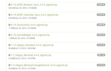

You're confusing me. Are you talking about the link that says "Gapps>" on their page?

Ok, I downloaded the gapps, then went into fastboot USB, tried pushing the zip to the phone, and device not found. I'm using your tool kit
Don't use my toolkit for now. Mount in recovery. Drap the gapps to your phone that way.
