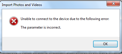

I am Having the same problem. cant seem to see any solusions. I have already installed everything from Keis to anything but still. when i connect my PC, below Pop up is showing
The parameter is incorrect. please help
Welcome to the forums!
When this happens, what mode is your phone in - Installer, PTP or MTP?
It looks like the phone is in PTP mode and at some point in the past you clicked on one of the behaviors in Windows and selected the 'do this every time' checkbox and now there's a problem reading the media on the phone and Windows is too dumb to figure it out.
Do you have an SD card in the phone?
