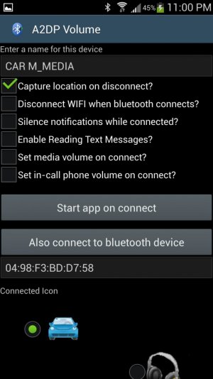

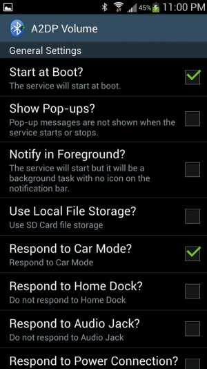

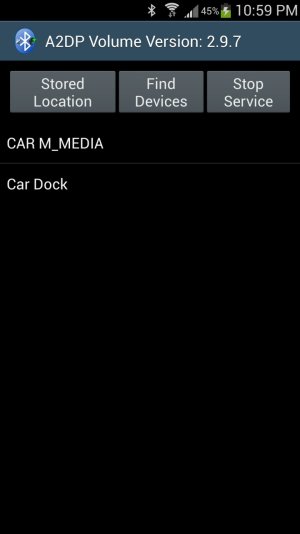

I have a 14 forester and almost returned the phone because bluetooth was screwy.
Download this app
https://forums.androidcentral.com/e...store/apps/details?id=a2dp.Vol&token=Y6c5y8Wg
In the main page press menu button and select "preferences" and set them to what I've attached.
Then pair to your car so it shows up in the app like seen. "car media" in my case.
Now click on "car media" and select edit and set the options to what I have.
Reboot your phone and hopefully it fixes it for you. I keep my bluetooth on 24/7 though.

Re: Blue Tooth, paired, but not connected.
I'm a huge fan of the A2DP Volume app. Been using it for ages.
So many good things about it:
Adjusts phone and BT media volume
Collection location data to help find parked car
Start up app on connect so you can have your favorite media player run instead of stock app
Reads texts and GTalks messages (doesn't support Hangouts yet but if you don't take or uninstall the Hangouts update it will still work)
Great developer support. Used it for a long time before I had to contact dev about issue. Turns out he lives just a few miles from me!!
