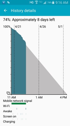

I've only owned my phone for a week, so I'm new to this game (and only part of the smartphone game since August). So far my phone is around 50% when I go to bed and I don't plug it in while sleeping, losing only an average 4% overnight. I charge it after I wake up. Yesterday was my longest stretch with it and I went over 24 hours with only about 13% worth of charge between there and it was at 25% this morning before I decided to plug it in.

I cleared cache, did a factory reset and fully charged my phone. This morning, when I unplugged at 100% it said I had about 5 hours! Ugh! That is terrible compared to what it was before lollipoop. I don't want to have to go through the trouble of reloading kit kat, but it might be worth it.
Do I just need to clear cache and try it again? I'm at a loss.
