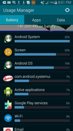

65% percent battery usage by the system and the screen????
Do I really need to do a factory reset??
Ridiculous
Battery is running down in 7 hours...not the 14 it states on this screen

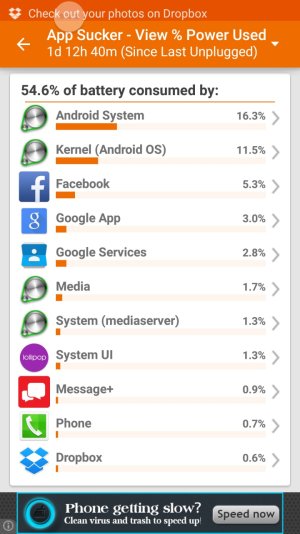

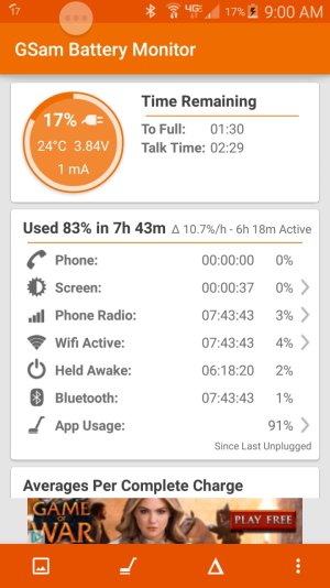

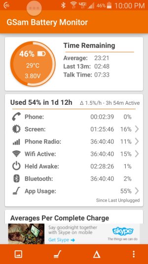

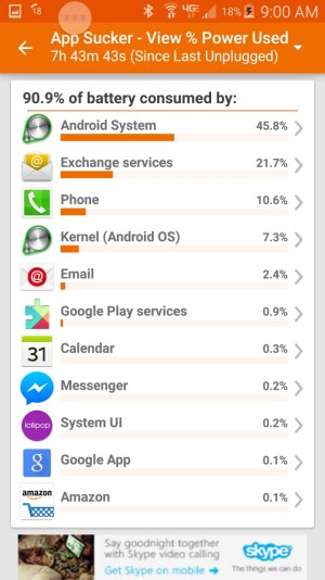

This is what worked for me. After updating to lollipop, Initially it ran like crap. So I wiped the cache. Then I resorted to a factory reset. This made things much better but the battery drained really fast. Was having to plug in at about 8hrs. Normally I can go a day or more without charging. I ended up Disabling Google + and uninstalling it's updates. Ever since doing this, everything is back to normal and even appears to be better than it was before. The attached photos are from before Disabling Google + and then after. What led me to my conclusion was the finding that the Android OS was the main drain. I tried Google + first since I don't use it. And it worked. Good luck. uploadfromtaptalk1424747740034.jpguploadfromtaptalk1424747754604.jpguploadfromtaptalk1424747768871.jpguploadfromtaptalk1424747777118.jpg
