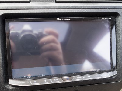

Upon my very first connection, it wouldn't work but I think once Google Plap Services updated it's been fine. I'm not sure because that's how quickly the problem cleared up.
Olytechy
Mar 11, 2016
6
I had this exact same screen before, I also had it show the entire "click ok to continue" screen as well, just it was locked up so I couldn't click ok.
So far no solution is working for me.
