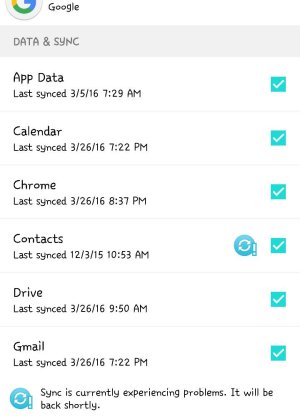

What do I do with this problem - trying to avoid factory reset.
When I opened my dialer for the very first time it was showing loading contacts for a long long time to the point where I couldn't wait and at the same I wasn't able to get to the actual dial pad so I had to close it. Tried another 5 times with the same result. Eventually it just worked - opened normally. But just know I realized that most of the contacts I entered in the last month or two are not there and this what I saw when I went into the settings. I kept trying to sync again - turning it on and off and still showing the same message on the bottom.
Note- I wiped cashed data right before the update and after.
Mine does this every time, and did the same thing in Lollipop, as well. Never could get the contacts to sync.
I got rid of Google saving my contacts. Use Verizons cloud and SD card now. As I always had problems with contacts sync with Google. Or when it did sync them, there were only 1/4 of the contacts that would sync.
