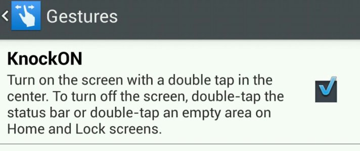

It was probably in one of those popup tips that show up on your screen when you first used your phone.
Under lock screen in settings out says tap on center of screen.
Tapatalk mofo
