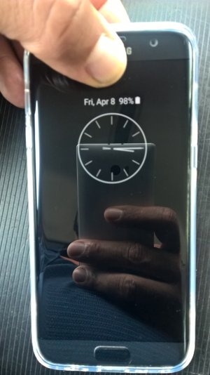

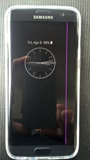

I have T-Mobile S7 Edge since March 1st without any problems whatsoever...However, while at work tonight, I had a Vertical Purple Line appear on my screen out of nowhere. I have a UAG case on my phone and haven't dropped it or anything. I was pissed off, to be honest. After about 4 hours when I got off work, I got in my car and turned on the phone, it was gone. Has anyone else experienced this?
That sounds strange. I would recommend returning it for warranty service if it happens again.
I guess, I will have to call Samsung because this problem keeps occurring. It will go away for awhile and them reoccur. Sucks because outside of this issue, the phone has been flawless
Another victim... It goes away if you apply light pressure just under the UNG below the speaker.

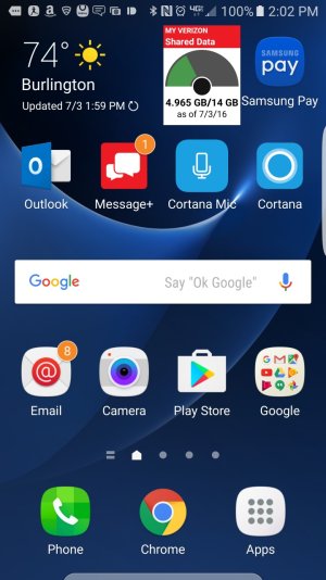

My Galaxy S7 Edge started showing this vertical line about a weeks ago, only it's pink, not purple. Furthermore, it was initially a single line although now it's usually a "double" pink line with one line thicker than the other. I've included a screenshot.
This line also started appearing out of nowhere. My S7 Edge has also been working flawlessly for the past few months or so and it's never been dropped. All-of-a-sudden, the line was just there. I don't remember exactly when it first appeared but it is pretty annoying.
I talked to Samsung support a few days ago. The tech, of course did not believe it was a screen defect and had me try several things, none-of-which helped any, of course. He recommended that, since I have insurance with Verizon, I try Verizon first since the replacement would be a lot faster and more efficient. I'll probably check with Verizon but tend to think I'll be better off having it repaired under warranty from Samsung (although I don't particularly like the two-week wait). I have to check my Verizon insurance but, if I remember correctly, it's not a totally free replacement. The Samsung Tech is supposed to call me back in a few days.
Does anyone have any comments or suggestions? I'm also curious as to whether or not a screen replacement would require a factory reset of the S7? Thank you.
UPDATE: After previewing my reply before posting it, I just realized that the screenshot I uploaded does NOT show the vertical pink line(s). I thought it was there when I first created the screenshot. But it's definitely not there now. I'll upload another screenshot later if I can get one that shows the pink line(s). Sorry about that.
