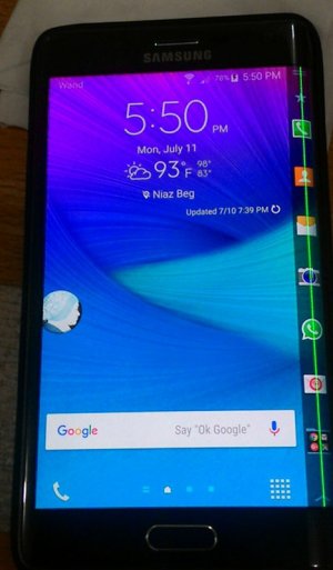

Hello Guys,
i have a Samsung Note Edge, yesterday while walking in market, without any reason i got a green line on my Note edge screen on it's edge.
no dropped or fallen and also not any force or weight put on screen. any one have idea our solution ?

Hello Guys,
If u have warranty then claim it...or else u need screen replacement
