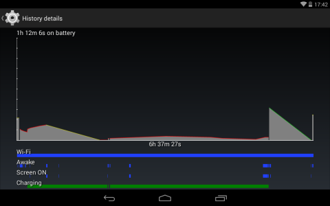

Stranger and stranger. Long spell of charging, then it goes straight to 0%. So I leave it turned off for a while (not connected to charger), then turn it back on and miraculously it now has 32%! Which then jumps straight to 0 a few mins later. Now switched back on again, and it's back up to 24%!! See attached.

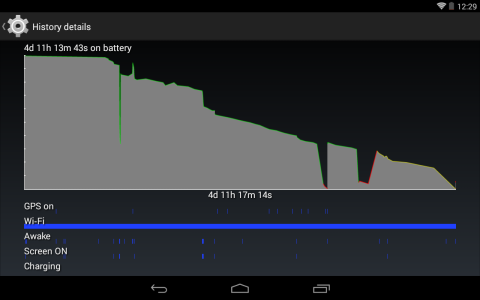

UPDATE!
OK I'm getting somewhere now! Here's a screenshot of the last few days from full charge. And yes it did fully charge, don't know how.
My initial suspicion, looking at the chart, is the battery is fudged, especially going by the sharp troughs where it jumps significantly down and back up. Would anyone agree on that?

Re: UPDATE!
I suspect your issue is not calibration, but you may as well want to try that. lithium battery charge circuits lose calibration over time, if the user partially charges and partially discharges. (Yes, using the battery between... oh, say 25% and 80% is good for the battery... but bad for calibration.) The solution is to recal the charge circuitry. You do this by using the device (tablet, phone, whatever... as long as it is using lithium batteries) until it dies from lack of charge. when this happens, try restarting it (most have a battery reserve function that shuts it down before you fully discharge.. which is often fatal) and let it die again. when you get down under 5 to 10 minutes of life, then plug in the charger and let it go to 100% without any interruption of that charge cycle. Basically, you are retraining the charge detection circuitry to correctly recognize empty and full. Many laptops come with instructions to do this on a regular basis.

Re: UPDATE!
Yes I did try that, what I did was removed the battery and I unsoldered one of the cell tabs from the circuit for a minute, thus resetting the circuit (it didn't power up then until I reapplied power by means of the charger). However the sudden dips in charge concern me, it shouldn't drop from 87% to 36 and then back up again. Same happened a couple more times as you can see from the chart. I do believe it was left dead for quite some time before I was given it to look at, probably due to their having lost the charger and were attempting to use a 700mA phone charger with it - obviously insufficient !
