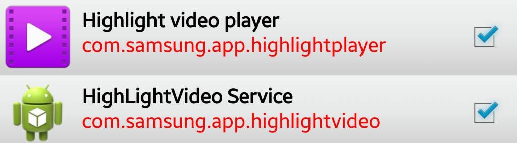

For the video highlight, there are two files, I have them disabled with Package Disabler Pro, don't know if you can disable them through the application manager or not.
I'll post the two files.

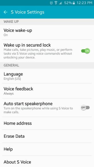

With S-Voice it works when the screen is fingerprint locked for me, though I haven't tried it with headphones. Let me do some testing on that.

Ok mine worked with headphones connected. You do have this turned on, correct?

yes i do have it on, it is just not working. i must use the voice wake up command? not enough just long press?

I have no idea if you can disable those files in the Application manager, like I said, you will have to search through it and see if you see those files.
i do'nt see it with the normal list. i tried different apps free ones but i can't disable this feature :(
On my Verizon Note 5 I can find those two files at Settings>Applications>Application Manager>All. Then scroll down to "Highlight ..."
The only option for both of them without rooting or using the package disabler app is to "force stop" which will be overruled the first time one of them is called by the OS.
