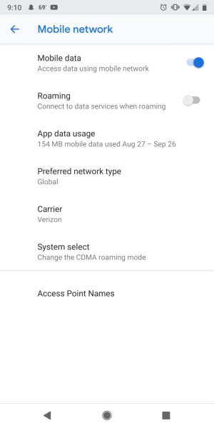

This has been a problem since I got the phone which was about 4 months ago. The first time I restarted the phone I suddenly could not connect to LTE. I tried everything and finally just factory reset it which fixed it, until I restarted it again. After a few days of this I went back up to Best buy which is where I originally bought the phone. They fumbled around with it, switched it out for a new one, and went through a couple sim cards to no avail. We got on the phone with Verizon and they couldn't find any issues.
The mobile settings is missing quite a few settings including VoLTE. I finally stumbled across the *#*#4636#*#* code and flipped VoLTE on and suddenly I had LTE. This worked for a few months, I didn't have to leave VoLTE enabled to get LTE I could just toggle it and it would connect. I could also put the connection to LTE only and then switch it back to the default setting and I would have LTE. This worked for a few months.
Now, the only way I can get LTE is to leave VoLTE on. The problem is, when I do this and I try to make a call it says server error and disconnects. After that the settings reset and I'm left with 3g once again. I've noticed that if I toggle mobile radio tower it will connect to LTE however voice network type will say unknown and then it will disconnect. If I put it on LTE only it will not connect to anything unless I have VoLTE enabled. I also noticed that it will only stay connected to 1xRTT and EvDo-rev.a. The last thing I noticed is that when it connects to LTE the network says Verizon wireless, however when it connects to the 1xRTT and EvDo-rev.a it says the network is Verizon.
Does anyone have any guesses what could be happening?

Booting in safe mode did not help. Also there is no way to change APN, it is set on VZWINTERNET, I did reset to default settings however which did not seem to help.

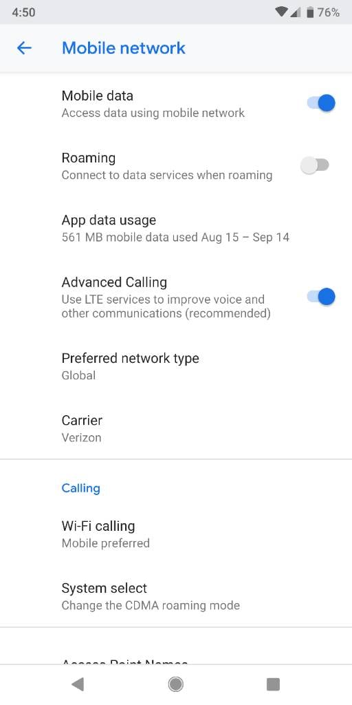

I don't know if it'll be any help but here's my settings.
