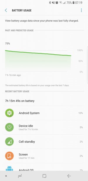

Same as before, Android system eats the biggest chunk of the battery.

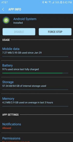

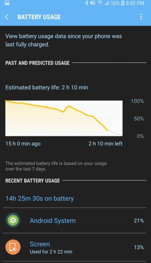

I am getting terrible battery life as well. Just created an account so I can just say how bad Oreo has wrecked my S8's battery. Mine is on AT&T if that makes any difference. I've also noticed that my phone seems to get hot more, that may be due to the system running for no reason.

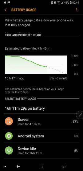

updated to Oreo. battery was horrible. after reset now good
When you reset did you have everything reinstall from a backup or did you just redownload everything manually?
only sms and contacts restored from back up, rest downloaded manually. preferred if you start clean without anything from back up.
