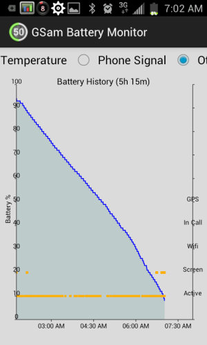

I'm not sure which thing was making things go crazy, but it appears I'm getting back into more normal territory, though it still seems low. Here are the screens from this morning after 9-1/2 hours off the charger. I unplugged at 9:30 pm and went to bed around 1:30 am, awaking (OK, hitting the snooze) at 6:45 am. Compared to being under 50% after <6 hours, this is much better, but shouldn't this be better when on wi-fi with full phone bars?
Compared to before (see screens), the wifi isn't running constantly, but there's still that hour of awake time in the middle that's unexplained. I'm also concerned with the power usage by GPS Status since I wasn't using it AND I killed the process early on when I saw after an hour unplugged that it was running. Weird.
This is actually looking pretty darn good to me. I imagine that random active period ~ 3am is going to be your apps running background tasks; ie checking email, looking for updates, etc. GPS status is definitely acting erroneously, the worst part is that apps uses a lot of resources and tools so it can really jug your battery. I would keep an eye on GPS Status but other than that I think with the large amount of apps you have you are looking pretty good on battery life. I imagine you are leaving wifi on over night because you want notifications/emails? If it isn't important turning off wifi will save you tons more battery than leaving it on, because all those background tasks will get cancelled out.

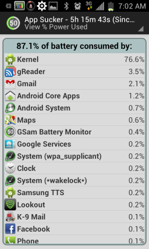

Resurrecting this thread because now my battery is dying rapidly, but I can't see any applications causing it. Yesterday, it died in about three hours of use (mostly gReader) in an area with a decent signal and as the attached screen shots show, it drained 80% in 5-1/4 hours with no visible awake time or use, though the Android OS screen clearly shows it being awake the whole time. Note how the screen shots show it going from 9% at 7:01 to 6% at 7:04; it was at 12% when I woke up around 6:55!
Last night, it ran down in about 6 hours and I charged it to about 92% before turning in. (My charger isn't near my bed and I use the phone as an alarm.) Previous drain issues have shown up as the phone being held awake, but now it simply seems to be dying. Since the last posts, I'm now on rooted stock ICS 4.0.4 and battery life has been normal. No apps have been added recently that can explain the sudden dive. One thought that occurred to me is whether the battery itself has worn out? It's only 11 months old, but are these things so cheaply made that they simply don't last? Is this covered under warranty?

In gsam, there are lots of reports. % of cpu was not as helpful as minutes held awake, num times awake, etc.
Didn't think to look at that. I was freshly awake and not thinking.

When I tried different settings for "Keep WiFi on during sleep" neither "Never" or "Always" seemed to make much difference, but "Only when plugged in" seemed to actually help. My phone gets to DeepSleep much more often (unless it's plugged in, which doesn't really matter) and seems to drain slower. The downside is that now WiFi sometimes (but not always) doesn't re-connect when the phone wakes up. Doesn't make any sense that "Only when plugged in" acts much different than "Never", but maybe there's a bug in that bit of code?
I already had this set to "only when plugged in" and it's hit and miss about latching onto wi-fi, but as the shots show, the wi-fi is off. This was a problem before.
