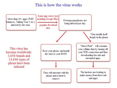

It roots your phone, grants superuser access, install itself onto ROM.
Trojan: Ghost Push
Do not install these apps. They are trojans.
Don't give up...
Go to the Google Play Store, Search for Ghost Push Trojan Killer, Select the 1st option, Install, Run.
Trust me. It's your only chance.
(It may cannot survive ROM update)
(I'm not the creator of the program)
