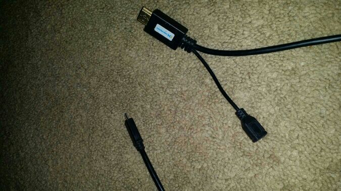

Please help, I am at my wits end.
I have tried all the mhl cables for the Galaxy Note 3 and have now bought the official samsung white one. I plug it in and even add power to it but nothing.
Am I missing something?
Try hooking directly into the TV with your phone in airplane mode. I have an older MHL adapter that actually works better with the 11 pin adapter because it works through my receiver. The Samsung adapter recognizes if you are hooked into anything other than a tv and wont allow it to work. Mind you, the samsung MHL cable will allow 1080P at 60hz whereas the older mhl cables with the adapters will only allow 1080p at 24hz I think. I still prefer the non-samsung one so that it can work through a receiver though.
Did you get the Samsung MHL 2.0 one? I don't think the samsung galaxy s3 one is compatible, it needs to be the galaxy S4 or higher I think. You should still be able to use a 5pin to 11 pin adapter though.
