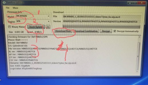

My picture shows circle on what you need to do
Put your model number,region select check for updates , then download the Rom , extract the Rom with 7zip
In the samfirn tool put
Your model number
Your region , example t-mobile =TMB

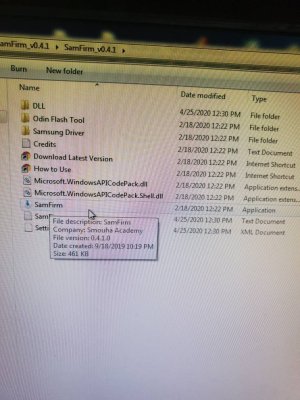

I extracted the SamFirm.exe file, do I extract some other files within the SamFirm folder?
Once you extract , open the file and look for samfirm application and drag to your home screen or task bar at bottom that way you can open the tool later

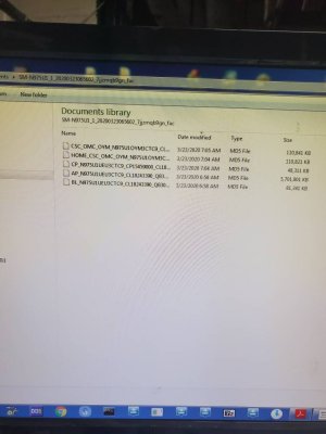

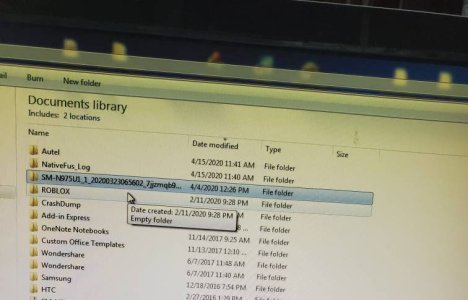

So once you download the firmware and extract it should be in libraries >documents
This is example firmwares in my screen shot (not yours)20200428_193517.jpeg20200428_193537.jpeg

In samfirm tool
This what you put
1.model
2.region
3.check for updates
4.download
