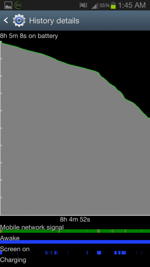

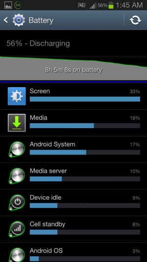

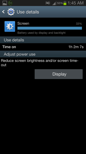

Second thing is to post some screen captures of your battery status and related information.What you displayed doesn't tell you anything about which app(s) might be draining your battery. Go to Settings / Battery, and do a screen capture. Then tap the graph, and capture that screen as well. Hit the back button, tap the line that says Display, and capture that one. Post all three screen captures here.
What's the state of your battery after two hours charge? Is that 8 hour drain starting with a fully charged battery? What percentage of battery is left after 8 hours.
Almost down less than 50, yes coming from full charge.. almost full after 2 hours and it is without using the phone after disconnecting charger after 5 mins there goes 1% and after 5 mins another 1%

The Awake bar (in the last screenshot) shows that the phone is awake for the whole time (almost 9 hours), which is certainly killing your battery life. The 1st screenshot shows that you have Media (streaming?) and Media server running, again leading me to believe that's what is causing your rapid battery decay. Your Screen time looked pretty normal at about an hour for ~9 hours of On time.

As GSDer mentioned above, the battery history is showing that your phone is awake for the entire 8 hour period. You can also see that a third of your battery is being used up by your screen.

Since you didn't start with a fully charged phone, it's hard to know what your battery life really is. How long did it take for the battery to drop from nearly full to 50%? Next time, make sure you charge the phone to 100%, which will reset the battery monitor, and then track usage until you're down to about 50%, and repost the images then. But IF you're really getting 8 hours of battery life at 50%, that's really nothing to complain about. If you didn't charge to 100%, that's probably not accurate, though. To repeat: You MUST charge to 100% for the battery stats to really be meaningful.
Media gets used any time you download any file. So if you downloaded videos, or programs, or any large file that will account for quite a bit of usage. And media server gets used whenever you watch a video, whether you're watching it online or not. So if you downloaded those videos, and then watched them offline, that could account for quite a bit of battery.
But since your phone isn't going to sleep, something else is probably wrong. Heavy media server usage can be caused by corrupted media files. Are your videos on a removable SD card? If so, try removing the SD card, reboot, and see if that fixes the problem. If they're on internal memory, I'd suggest copying any files you want to keep to your computer, delete everything from the internal SD, reboot and see what happens.
So: remove the SD card if that's where the files are. Delete the media files from you internal SD if that's where they are. Reboot the phone. Charge to 100%. Let us know what happens.

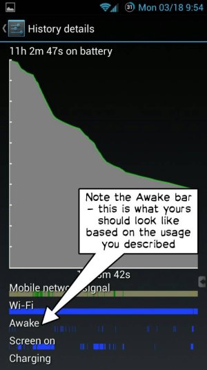

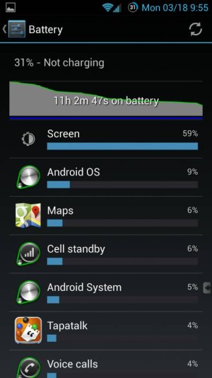

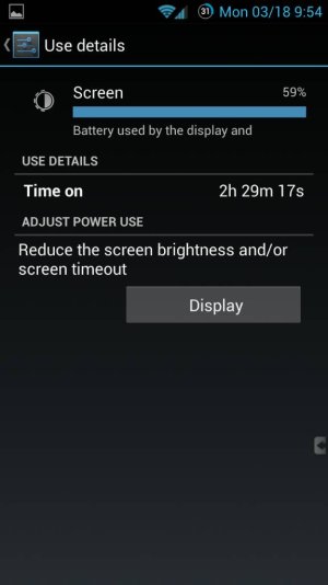

See below for typical battery life data that started at 100% charged. The usage was similar to what you described except I didn't watch any videos. uploadfromtaptalk1363669567022.jpguploadfromtaptalk1363669595030.jpguploadfromtaptalk1363669611684.jpgIt looks like you had a rogue process running the whole time, even though the screen was off much of the time, causing the phone to remain awake the whole time rather than cycling through normal sleep states.
