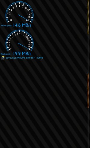

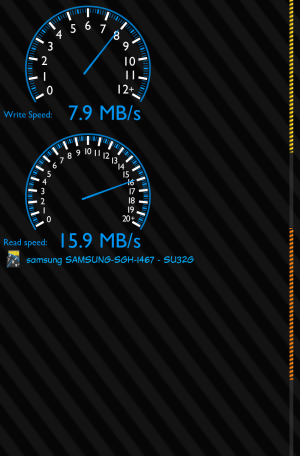

Farish, I'm sorry that what you've read tells you differently but I have both the Sandisk Ultra and Extreme micro SD cards. Both in the phone and via USB my 64GB Extreme is consistently, easily, and noticeably faster in reads and writes than the 64GB Sandisk Ultra I have. Do you believe the Sandisk Ultra I have is defective, my Extreme is performing better than it should be or something is wrong with my S4 that would explain the gelow graphs? I may not be getting the UHS speeds of 80 MB/s on the Extreme but I'm getting way better performance (nearly 2x write speed) than my class 10 Ultra.
This is the SD Tools graph for the my 64GB Sandisk Extreme
This is the graph for my 64GB Sandisk Ultra
The difference is tangible as the Extreme writes nearly 2x faster at 14.6MB/s and reads noticably faster as well as is shown.

My 25/10 vs your 20/15 is not that huge. I get about the same as you with my Samsung sd card. My point is without UHS you aren't going to get better because of bus limitation s.
