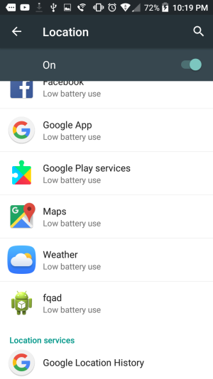

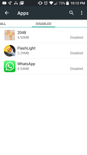

Thanks B. Diddy to reply. I appreciate that. I send you the pictures of apps i blocked that malwarebytes can't remove.Screenshot_2017-01-10-22-12-17[1].pngScreenshot_2017-01-10-22-19-19[1].png. In second pic, the fqad app as a sys one.
Flashlight apps seem to be associated more often with malware (probably because they're one of the more popular types of apps people search for, even though Android includes a flashlight toggle in its Quick Settings menu), so if you installed that one, it might be the culprit.
Hello. I didn't install these apps. This is why i disabled em, but I still have pop up ads and apps that are downloading by themselves even though I turn off the unknown sources.
If these apps always come back after a factory reset, then the only way to get rid of them may be to reinstall the firmware, as I mentioned previously.
