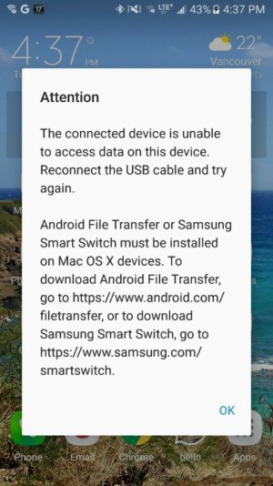

I must acknowledge that even before the Marshmallow update my Android Auto was finicky with my 2016 Civic LX. Just before finally not working at all, I used to connect my phone and this would somehow render the entire audio screen black - as if it were off. My phone is a Galaxy S6
Then, since Marshmallow, I connect my phone and the Android Auto app on my audio screen isn't even there anymore. If I launch the app from my phone it tells me to connect it - when it is, in fact, connected.
Shortly thereafter I will get this very bizarre error message on my phone which, to me, is entirely unrelated to the issue. a) why is it mentioning Apple b) why do I need Smart Switch?
My only thought is that, for some reason, my boyfriend's use of Apple CarPlay in my car is throwing my Android Auto off? Nothing else can explain the error message on my Samsung.
