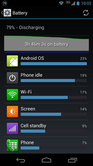

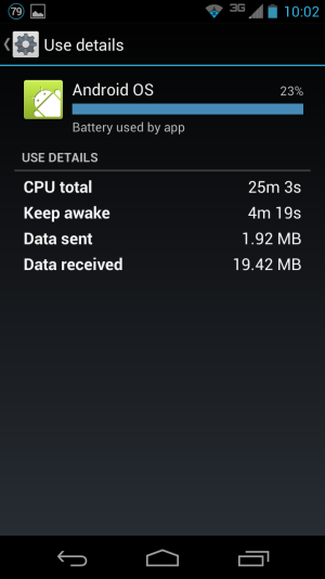

I have a Razr Maxx HD, love the phone and the battery life, but every once in a while it will have Android OS suck a lot of battery and I wont be able to get through the day with it. Is there something that I can do to stop this?

Based on the screenshots, I am going to guess at 2 things: 1. Your device is idle a lot. That is why the OS is so high. The OS is only taking up 23% of the 21% drain as shown in your pictures. 2. You cell signal look very weak. Your device is probably spending more energy maintaining that weak signal than the OS is draining your battery.
Test to see if I am correct: Put your phone in Airplane mode for a little while. If you make it longer throughout the day, then it is the cell radios that's killing your battery.
In my area I am in and out of coverage all the time (this was the reason I got the Razr Maxx hd), i understand that and can live with it. It's just that once every week or two i have the Android OS go crazy and suck the battery down on me. I would normally be in the low 90% to high 80% range at this time of the morning.
