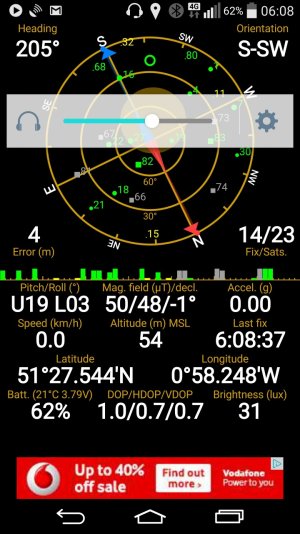

Install GPS Status & Toolbox. Run the app. Turn GPS on. Watch what's happening. Does it know which satellites are up? (If not, the phone is defective.) Is it receiving signals from the satellites? (if not, either you're in a bad area [lots of leaf cover overhead, lots of steel buildings reflecting signals, lots of electrical noise in the area] or the GPS receiver is defective.) Is it locking to at least 5 satellites in a reasonable time when you're standing still? (If not, either the GPS receiver or the GPS firmware is bad.) Initial locking with a constantly moving receiver, especially if you're in an area where there's a lot of stuff to reflect signals, or there's a lot of varying overhead leaf cover, presents a problem that can only cured by changing the laws of physics (IOW, that's not how GPS was designed to work). For horizontal position, you need at least 3 satellites. Four will improve the accuracy, due to the lack of an atomic clock (or something of that accuracy) in the receiver.
Once you get a fix, look at the DOP (Dilution of Precision). If it is higher than 6 you don't have a good fix. Under 4 is good enough for a general location. Less than 2 means you have a very good fix.
If GPS Status shows a fast lock, but the app doesn't lock, or GPS status knows where you are but the app doesn't, it's the app that's at fault.

Everything looks fine with my gps status so it looks like mapmyrun isn't great at locking in. Perhaps it's a lollipop compatibility issue?
