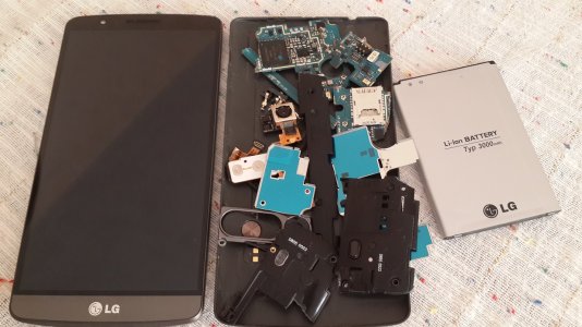

Having the flickering issue for so long without a solution, decided to break the phone into pieces then throw in trash today. I believe I did the best thing.
Bye bye LG
Never buy you anymore.
