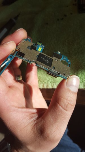

Today I baked the motherboard in the oven. 300F for 8 minutes.
Could have used a sprinkle of salt and pepper, possibly a dash of garlic powder. And I think I chipped my tooth on the CPU....
Kidding of course. I did bake it and it powered up beautifully, I couldn't even get that previously. Thinking I'll run it at work tomorrow and pack my S4 along just in case.

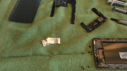

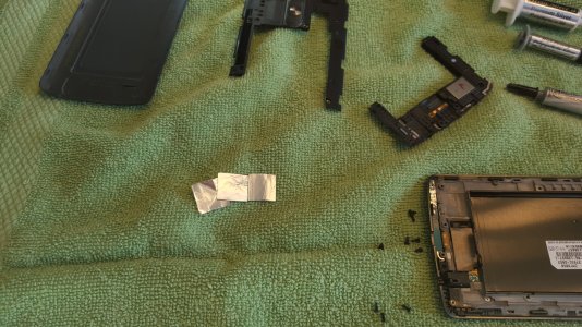

Ok, I figured I had nothing to loose so I baked my board too. 9 minutes at 325F. I also cut and folded up aluminum foil to fill the gap between the processor and aluminum chassis. I then applied thermal paste to the processor and aluminum chassis and "sandwiched" the aluminum foil in between. Phone is working flawlessly now! I didnt want to add alot of thermal paste to fill the gap because I know that can trap heat. So folding aluminum foil and using paste on both sides transfers the heat to the chassis. I'll update in a couple days but so far the reflowing in the oven seem to be working. Time will tell.foil resize.jpgrecessed processor resize.jpg
Smart move using the aluminum foil. I just added some more thermal paste (I had a "hole" in my coverage, so I filled that in)

Joining the tinfoil brigade myself. I baked 9 min at 325, and used aluminum foil + Arctic Silver to fill the gap. I will, of course, keep you all posted.
EDIT: Not sure if it matters really, but I baked it CPU side up.

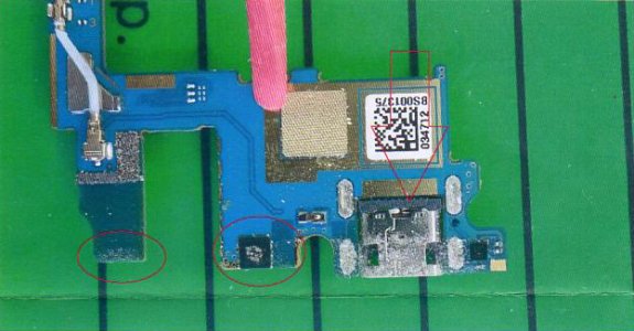

Hi all,
Here's my experience: Got my D855 through Carphone Warehouse in September 2014, after returning a 5 month old Sony Xperia Z2 due to major overheating issues (admittedly I was using it in Afghanistan ~50c!). So, my phone is only 17/18 months old. I've never messed about with ROMS on this phone, something I always had to do with other Android phones to get the best out of them. I love this phone, when it works.
The phone had previously been back to LG to replace the entire front, due to cracking across the mic hole and IR blaster, a known issue for which LG will repair regardless of warranty, (something the rest of you may use as an excuse to get the screen replaced, to see if it fixes this issue). All has been well for a couple of months since, until one morning the other week when I took my phone off charge in the morning and the screen almost immediately did a funny fade to black, like in this video I uploaded to YouTube: (It's video yXwL5KvS06o, I can't post links here)
As an IT Coordinator by trade, I did a bit of troubleshooting myself, which included the step of trying to factory reset the phone from the recovery menu, where the phone still did the fade to black thing. This leads me to believe that it is not a software problem, as the OS hasn't even thought about booting at this stage. Please, correct me if I'm wrong on this.

I let a couple more days go by and rang them. A lovely lady was very helpful and told me my phone had been released for depatch and I would hear from DPD to arrange delivery. Guess what? Nothing from DPD until a fella turned up with it. Fortunately, I was in the house at the time. So I open it up to find the attached letter saying they hadn't fixed it as it had water damage. Well, it never had water damage when I sent it to them, so I have no idea where that's come from. They also included a photo of some random electronic component, with some arrows and stuff on it, none of which means anything to me as a non-electronics engineer.
