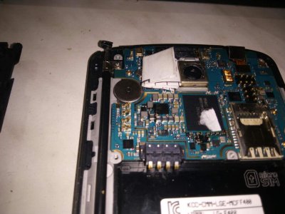

Hello everyone, i have bought the LG G3 F400L (Korean version) from fastcardtech.com for around 130$ (refurbished). It had the fade out problem out of the box. I was skeptical to try out if it would work with the paper trick, but finally i have done it.
1. Carefully disassembled the phone.
2. folded a piece of paper 2x and carefully putit onto the camera connector.
3. Reassembled it all with great care. Run app updates in the background, set brightness to 100%, and started the stress test.
I know this might just be temp fix, until the paper flattens out and becomes loose, but so far so good.
I also heard people were applying thermal paste to the cpu, and it also worked wonders for keeping phone cooled well.
I would consider mobo reflow as last resort (i'm afraid of dealing with those small ribbon connectors... they are so fragile...)

1-make some small folded paper
2-open the lg cover motherboard
3-take the folded paper and put it at camera controller.. its that small space between autolaser and camera
4-close the cover....the paper will push the motherboard and i dont know why but it works
i have only 15 min i did that and im not getting anymore that issue....i will recharge now and hope it will not appear again
i wrote this to help u cus i know your concern about this.. i used to be sad for about 1 month since the problem occured...hope it will not appear anymore.. spread this method so others can know it.. thanks
I registered to thank all that posted but mainly this fellow here that made the issue disappear with a simple fold of paper..
Just fold a small piece of paper, make it 2 centimeters thin and place it between the laser thinggie and the camera lens..
Close the cover and that does it.. thanks bruv!!

Well the Paper thing worked for me, but in an easier way :p. Being a novice, I just followed below steps:
1. Removed the back cover of my LG G3.
2. Kept a folded piece of paper on top of the sensor on left of camera.
3. Put the cover back on.
Wait for few seconds, no need to restart your phone. Your screen will be working fine after that.

same problem here my LG G3 is always fading it turn into a dark color, I already tried a "paper trick" it`s work but in a few days my screen is fading again. what am I supposed to do?. help me please!
I went to an S7 Active back in June but recently I had to go back to my G3 as I had water damage. This is in the process of being replaced under warranty which means I had to go back to my G3. I have recently readjusted the Penny I was using in the phone to a new location as I continued to have the flickering. Since readjusting I have had better luck. See the attached photos for the location I have set the penny. The first picture shows where the penny is set and the second shows where the penny puts pressure against.
Thank you so much for this! My G3 was having the fade-to-black issue and this has kept the problem fixed for 2 days straight now... fingers crossed it lasts a while.
One caveat I noticed: the power/volume buttons are a bit more "touchy" than they were before. When I first shoved the penny in there, they were almost unusable but have been working fine after settling for about a day. I guess it deformed something, but in a good way!
