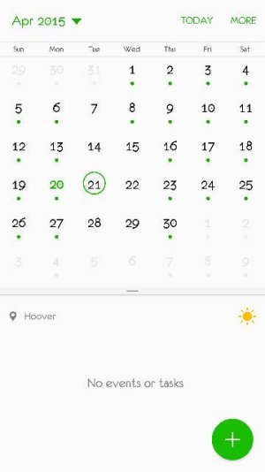

S6 Edge calendar now has green dots to indicate an event instead of the event itself
I used to be able to see the actual events on each day of the month but now I only see a green dot indicating there is an event. You have to click on that day to see what the event is. It was much better before when you could see at a glance your schedule for the whole month and not have to look at one day at a time. This change happened yesterday after having the phone for one week. Does anyone know why/how this happened? My phone syncs with my google calendar on my computer. Thanks for your help.

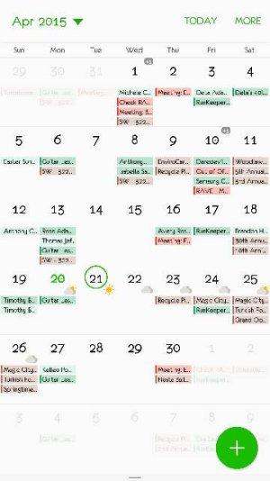

If your view looks like the following (1st screenshot), pull down the separator bar between the calendar and the event at the lower half of the screen (dash mark in the middle) all the way to the bottom of the screen. Doing that should show the calendar in the presentation you're trying to achieve (2nd screenshot).

Oh my goodness. It worked! Thank you so much! I probably unknowingly swiped it and got the "green dot" view but now know how to fix if it happens again. You're my hero. I was so frustrated. All fixed now. Thanks again!
