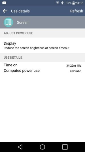

Screen: 2h 25m
Come on now, there's some serious progress there. GPS is now locked down. Computed power use in Android System went from over 700mAh to just 17mAh.
Your SOT is just 17 minutes short of what you posted yesterday yet you have 16% more battery remaining today than yesterday.
What is your up time? You mentioned charging last night, so if you didn't top it off this morning, your up time must be close to 20 hours today vs 11 hrs that you posted yesterday.

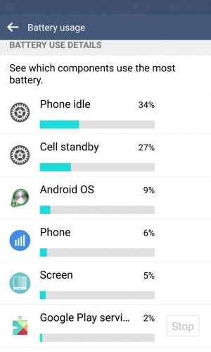

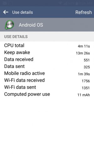

So I turned keep awake off of every app that showed up. Went to bed with 42%battery and woke up with 17%. Android os shows keep awake at 7hrs 32 min. I think my phone has glitched out and has to be sent in for repair.

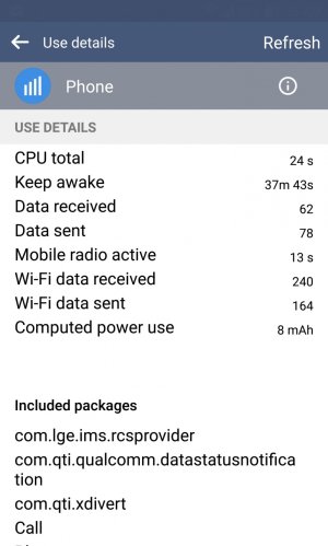

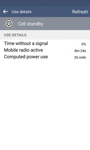

Can you click on those top 4 or 5 listings in the battery usage and post those screen shots as well?

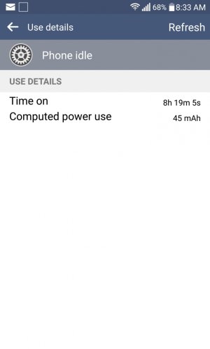

The phone went from 100% to 68% overnight. I left sync on and did a battery pull and replaced with a fully charged battery for the test. Note that prior to the factory reset it was much worse.
I don't see anything in those screen shots that would be killing the battery that much overnight.
We'll just have to wait until 6.01, which should include battery related bug fixes. I'm glad that LG was kind enough to give us early adopters a free spare battery. I'm finally using it.
He literally post proof the phone didn't use that much power overnight, so I'm guessing defective battery.
