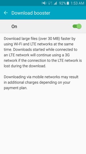

3 possibilities
1 - If it's happening ALL the time, you may either have the setting on in your S6 called "Download Booster"
This can be found under SETTINGS > More Conneciton Settings > Download Booster. This setting allows you to combine your mobile data and wifi for faster downloads. The LTE icon in your menu would have a little download icon below the lighting bolt. I would suggest turning it off unless you have unlimited data on your phone.

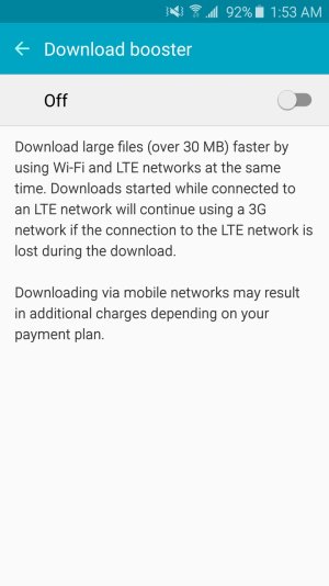

I disagree. It is not normal behaviour to have both symbols at all times showing. I am on an S6 and have been on the S4 and S3 before this, and that has never happened before. Unless it's in regards to the S6 and the specifics I posted above.
Note the difference. This is just one example I gave above. Mind you I have not seen a screen shot of the OP's LTE symbol,but if it looks like my screen shot. They very well could have download booster on.
There are many things to look at before this can be considered normal behaviour.
View attachment 224154View attachment 224155
