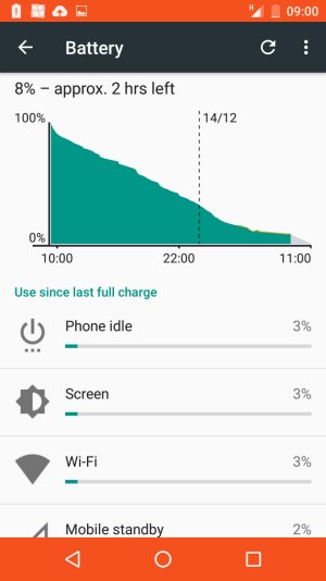

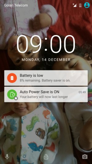

Thanks for the suggestion, I do check the apps, but nothing is using more than 1-3%, and I am not a big app user anyway - camera, whatsapp, and the regular phone functions of SMS and phonecalls, that's about it on a regular basis. I don't complain about the battery drain if I have been using the phone - but it crashed from 42% to 7% overnight, just sitting quietly in the corner by itself... And anyway, this has only been a major problem since the latest upgrade to Marshmallow and then Marshmallow 6.0.1 made it so much worse!
So I got up this morning (different time zone...) and found the phone gasping for juice...

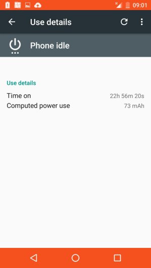

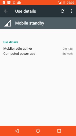

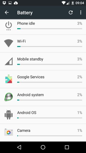

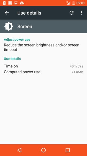

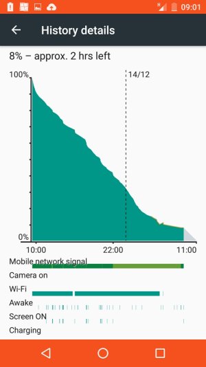

I took a bunch of screenshots, hope I captured the data you asked for and that it can help solve my problem? Many TIAs
Screenshot_20151214-090013.jpgScreenshot_20151214-090047.jpgScreenshot_20151214-090108.jpgScreenshot_20151214-090125.jpgScreenshot_20151214-090152.jpgScreenshot_20151214-090227.jpgScreenshot_20151214-090424.jpg
Hmm, can't find anything particularly unusual there besides the battery drain itself. Your cell signal looks mostly strong, Mobile Standby doesn't report any Time Without Signal, and no app seems to be using an inordinate amount of battery.
See what happens if you boot into Safe Mode: https://support.google.com/nexus/answer/2852139?hl=en
If it doesn't, then it's also worth trying to recalibrate the battery sensor. Charge to 100%, then use it normally until it shuts off from low battery. Charge up to 100% again, and repeat this cycle 3 times. Now see if the problem persists.
