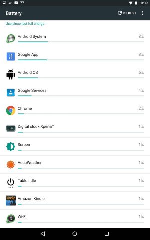

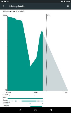

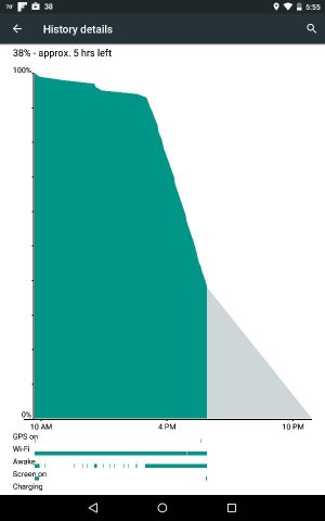

Here are requested screenshots. Thanks in advance.

It's constantly awake during the steepest decline, and I notice that the Google app is using a fair amount of battery. Do you have OK Google set for any screen? Open your Google Settings app, tap Search & Now>Voice>"OK Google" Detection, and try turning off From Any Screen.
