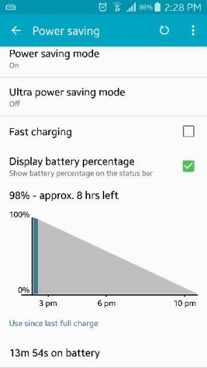

Is it normal ??? My note 4 darins 1% in 5 mins . My all bloatware apps are disabled and phone is on power saving mode . I bought this phone on 28 june .
Yestarday i was charging note 4 . I touch the phone its like burining hot i take off the battery and cool down . Now again i charged and not happen again overheating .
Sorry for my bad english .

Dpham00 , on 3:45 pm the battery was 87% after 2 hours of web browsing ,fb ,an 20 mins of playing furit ninja and rival the battery level was 62% on 5:45 pm . Is it ok ???

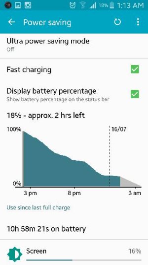

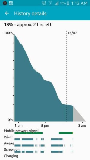

Here is some screenshots .
