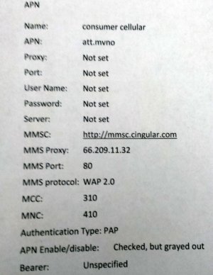

You could try changing the APN type. Below is a screenshot of my APN settings, as you'll see, my APN is different than the one that you are using. I am on AT&T, which is what Consumer Cellular is on. Try to see what happens when you change your APN type with the setting in my screenshot. There are NO spaces after the commas. Also, the above poster was correct, you will not get 4G LTE, the best you'll get is HSPA+ which is first generation 4G, or 3.5G. Lol
Sent from my GPE 5.1 HTC DROID DNA.
It helps to remember to attach the screenshot lol.

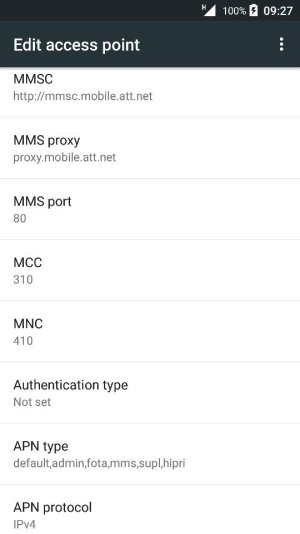

Thanks for the posting. I have kept playing with the settings. My wife's DNA is working fine, but my stopped sending or receiving MMS. I finally hit on a setting set that works. We're both using Messenger for MMS messages. I find if I'm in a low service area, the MMS messages might hang up, but will come I later when I het a high service area or WiFi. Here are the settings that are working for me.
Re: Droid DNA Mooving to Consumer Cellular
I'm glad to see you have it working. I see that cingular Web address show up a lot on services that use the AT&T system.
