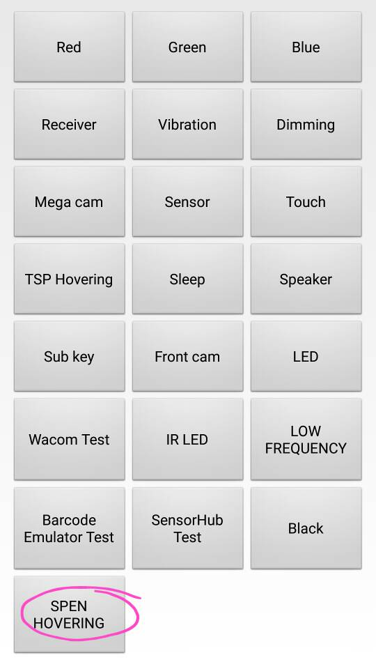

In addition to what Rukbat said, you can also do an SPen test by dialling the following USSD code:
*#0*#
This will launch a service menu that looks like the one pictured. Tap the circled (in magenta) option and do the test.
