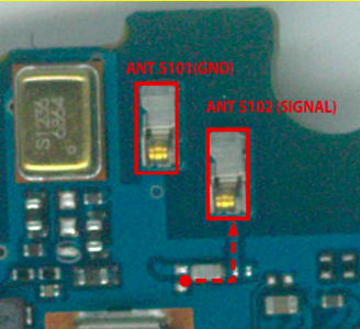

When I plug in the phone, I get a battery icon for a few seconds until the screen turns off. The icon, though, is a different, more basic one than it used to be (just a white rectangle with a percentage).
I noticed that a contact spring (or whatever it is; it's springy and makes contact to an overlaying piece), which I believe is a ground for the wifi, had part of it askew and in contact with an adjacent mic. (ANT 5101 in the following image; the flat grey cover above the gold pin was folded to the left and in close contact with the rectangular component)
I tried to fold the covering back in place, but it snapped off. It doesn't seem to have been a critical part of that component, but I don't actually know. I also haven't had the time to give it a thorough examination yet, though.
