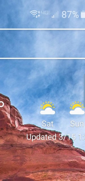

Finally had a chance to hook up my 802.11ax access point and connect my S10. It actually shows when you're using WiFi 6 which is pretty cool I thought.

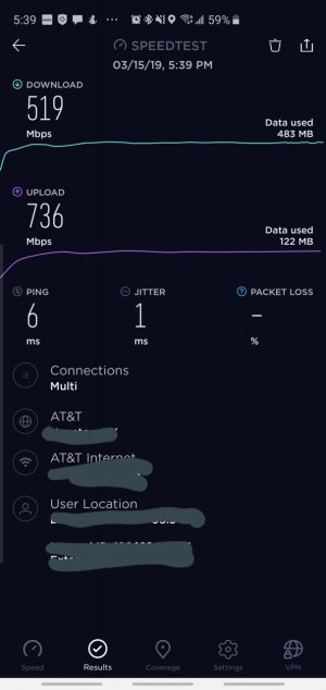

Cool. Have you tested you speed at all?
I have, and I'm seeing around 550Mbps down and 40 up. I have a 1Gb internet connection and I'm assuming it's being choked on the ISP side, not the wifi. I wonder if there's a way to test the speed just from the access point to the client, regardless of internet speeds. I'm getting the same 550Mbps on my wired connection as well, so that tells me it's my ISP slowing me down. This WiFi 6 can transmit up to 5Gbps if you have the backhaul to support.
