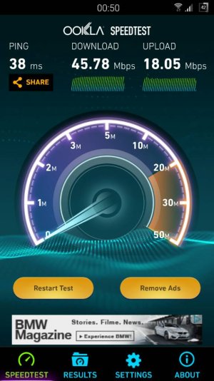

I get the wifi speeds I should at home. The ping is a little higher than normal but I am almost certain it's the server it's doing the speed test off of.

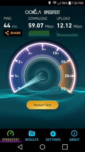

My fibre speeds although like Antutu they are rough guides as my ISP tested my line speed earlier today as I thought I had issue's in connectivity (all sorted now).
Engineer plugged directly into my line with results of 67 down 19 up.
