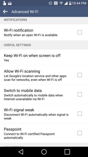

Stopped by a Sprint Store on my way home from work today, and I think they've fixed it for me. They disabled both connection optimizers on it, and that appears to have fixed it.

I thought they said there were two, but I can only find the Sprint one. I know my HTC One M8 had two.
They also turned off most of the settings on the Advanced Wifi page. The only one I changed was to keep Wifi on when the screen is off.
