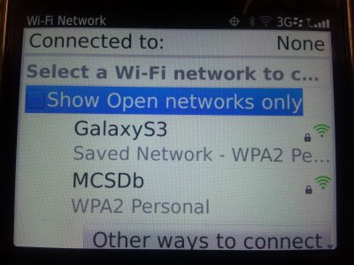

I have a sprint GS3 and I have done what everyone has posted. It shows up but when I try to connect it has a error message ""Failed to associate with the network" What could be wrong?
I am using the first one listed on the first page of this fourm. I included a picture from my balckberry. I am only using the black berry to try to connect to my GS3 wifi hot spot. I dont have a laptop so I am using my blackberry as a laptop to see if I can connect to it. You can see "galaxys3" is online, but if I try to connect it gives the error message shown in the other picture. Also only a small amount of info shows in the up load and down load box on the GS3 tether screen.
Please help.

Re: about Wi-Fi tether for rooted gs3
Ok update, I went and uninstalled the file on the first page of this post. I then went back and installed the newest file again. And now it works likea charm. Do know what the heck I did different, but yes this works with sprint!!!! Happy Happy.
