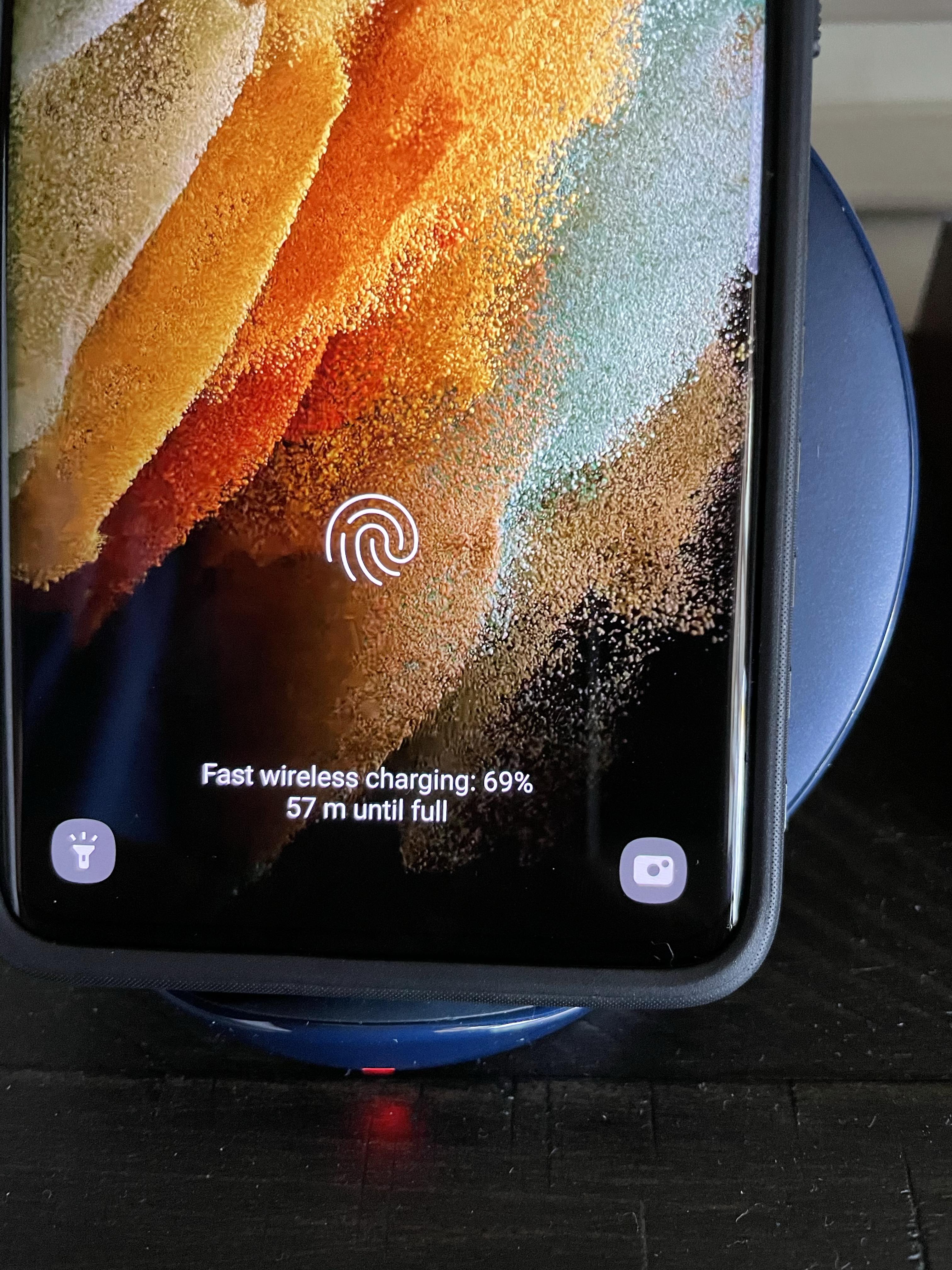

So I just tested my Moto Z4 Turbo Charger and an Anker wireless charging stand and my Ultra did in fact fast wireless charge. It appears that the issue is not manufacturer based but charger specification based. Samsung clearly states the the charging requirements:
"Fast Wireless Charging 2.0
USB PD 3.0 (PPS) certified Fast Charging for wired charging (AFC and QC2.0 compatible)*WPC certified Wireless charging"
Remember that The QI wireless spec is specific to the wireless charging type (Induction), cable type and some other features but really doesn't dictate charge speed, that comes from the specs of the wall charger.
Here's what I ran the test with.
https://www.amazon.com/gp/product/B...ag=hawk-future-20&ascsubtag=UUacUvbUpU6940184
bill-e, thanks for your input. After reading I fiddled some more and discovered the power block I have the wireless pad connected to seemed to match yours in specs so I connected to the phone directly using a USB C cord and it does indeed fast charge the phone. I thought maybe it was related to the mini USB connecting to the pad, but I see your Anker unit also uses a mini USB connector so I suppose it can't be that.
I tried connecting a Samsung adaptive fast charge power block to the wireless pad and it did not even register as a fast charge at all.
So, looks like in my case at least, the incompatibility lies with the wireless pad. Still makes no sense that it registers as fast charge displaying the shorter charge time for several seconds before showing that error message and reverting back to "normal" charging with a longer time to complete the charge.
