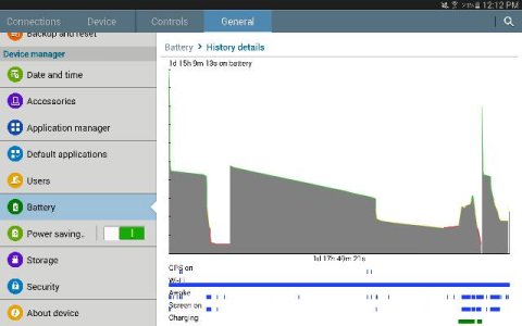

Here is a picture of my battery life. See the spikes up and down? That's the plunge in battery life, and the spike ups are after I reset....
Wow. I would do a factory reset for sure, and if that doesn't work immediately get a hold of Samsung support. That isn't just bad---- if that graph is accurate you're battery could easily fail epically. Possibly dangerously.

That is definitely not normal. Like others have said try a factory reset, and if the problem persists you could have a bad battery. You definitely do not want that battery getting to thermal run away. I can only imagine that it would be spectacular.
