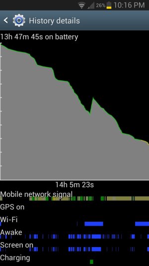

This shows your GPS on the entire time? I'll bet the phone is heating up if the GPS is on the entire time? I do not see it in the top menu though.

Yeah, the GPS was I guess, which is weird because I had to turn it on when I left work because it was off.

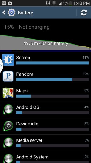

So, as a follow up to my other screen shots on the thread, here are some from today. Mind you, I had GPS off most of the day, Wifi off most all day and even had power save on. My reception is poor, but a coworker has the S3 and doesn't have any problems with battery life and she has the same reception with same carrier. What's going on with this? At the 8% mark you see, my screen on time was about 90 mins, which is nothing. Does AT&T have replacement batteries in store? Should that be my first route (try a new battery)? But, this should not be happening...right (new guy from iPhone 5)?
The entire time your phone was on GPS was being used. Hence the full blue bar. That is where your huge drain is... You have to find what is causing gps to ping you constantly..

I haven't used GPS all day. Just did it.. So you can't even see the bar on my battery stats. Yours is 100% filled so it's on all day.
Use the battery stats to find what it is.

I hear you, but you can see from the breakdown that no process that uses maps (as far as I can tell) was using a significant amount of the battery. Aside from the screen, the other percentages seem reasonable relative to one another. Right?

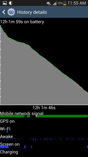

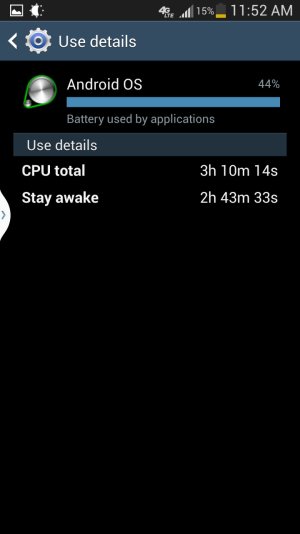

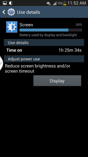

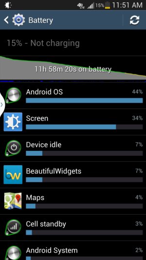

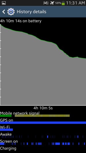

Ok Murphys law last night I had some crazy runaway process while I slept.
Woke up 11:30am (don't ask) and phone was warm on my bed.
Here are the screen shots. The only thing different was last night I turned on Air view and Split screen to show a friend and I forgot to turn them off.
In any case you can see something is keeping my phone awake and using power while I slept from 5am till 11am.
I'll respond back after I turn those functions off and remove battery for a few minutes to see if it fixes issue.

So I had GPS turned off,but that is not reflected by this information. Is there a reason it's still showing as on? I actually had the phone in airplane mode for nearly an hour.

Do you have Air View and Split Screen and SMart Stay and those new features installed? What about Beautiful Widgets?
Those are the only things that I added yesterday when my phone decided to go crazy overnight, before that my phone worked great for 2 charge cycles.
I suggest turning them off / uninstalling them to see if it fixes your issues, although your GPS usage is strange as mine does not show that yet I am experiencing similar battery drain since last night.
I think your phone is bugged if you had GPS off but it still shows on. DO a factory reset.

just a follow up my battery is working normal again. I took out the battery for 2 minutes and reset the phone and disabled air view, split screen and beautiful widgets.
If I were to guess I would say that beautiful widgets and air view had some conflicting processes. in any case everything is back to normal.
