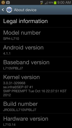

Did the method in post 2 about 2 hours ago. Working beuatifully but now i remember how much I hate how stock homescreen looks. Not being able to move the app launcher to where I want it in the bottom bar is very aggravating. So Back to Nova I guess. Guess its time to root to

it was very easy and it worked fine! Thank you!
Hopefully this will make the phone a little smoother and less "clunky/slow". Lag time is annoying!

Thank you, Skunk! I can't believe how snappy and responsive Jelly Bean is. It's totally noticeable.
Just updated with method in post 2 and no issues so far. Much appreciated skunk.
