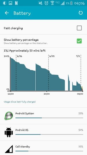

I am wanting to get some opinions from people that have this product and see if anyone has this issue. As stated in the title i have the 10000mAh battery with the case. I have been using this for 6 days straight, text, phone calls, facebook,netflix,music,pandora,heroescharge... Nothing Insane! I am now running into the issue when the battery get's around 5% if you take the battery out then place it back in the device it will register around 85% give or take. I have done this 3 or 4 times, and as i type this post, I am watching netflix . The battery is on 1% and the screen is VERY dim.. As you would expect from a phone that is freaking out and trying to save it's resources. Knowing that it's a 3rd party product and i'm sure that with all the math etc the OS not recognizing a battery bigger than what it was manufactured with. Or am I the only just trying to kill this battery and seeing the affects of this? :-\

The gaps in the battery usage pics are of me taking the battery out then back in. FYI
