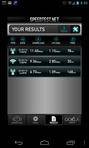

In am on ATT coming from iPhone 5 I just used the same Sim put the adapter on to change it from nano to micro and bam everything works I used the APN settings from this forum removed pta changed to phone and ways have all bars full H 10 and 15 speeds here are my resutls.

I used the first apn settings I saw and I saw not much difference except that I could actually run speed test. What page shows the best settings.
