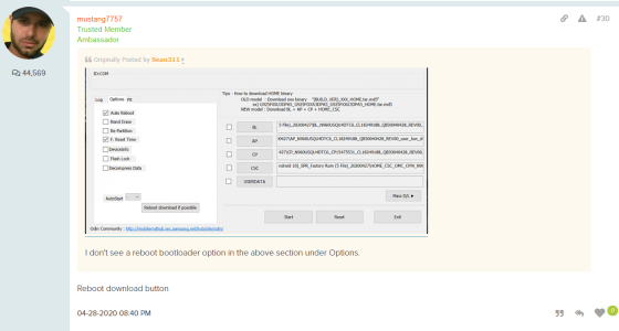

Hey I just saw a post of your from April 2020 where you helped someone flash their firmware and it sounds like they were having a similar problem as me. You you told them to hit the reboot bootloader tab in odin before hitting start. Here is a screen shot. Reboot Bootloader.png

Hey I just saw a post of your from April 2020 where you helped someone flash their firmware and it sounds like they were having a similar problem as me. You you told them to hit the reboot bootloader tab in odin before hitting start. Here is a screen shot. View attachment 323257
I also have another question. With Samfirm I can only download the t-mobile firmware. I suppose this is all the same base samsung firmware, correct? I found a link to an AT&T release from January 2020 to Android 10 with the same 2.0 ui (N960USQU3DTA4). Since I am on AT&T should i be trying to use this patch instead?
Hi, the only time you hit reboot bootloader, if for any reason the phone gets stuck while firmware downloads like half way , you need to hit that to restart the phone for Odin again or it won't allow you to flash again.
Try dowmload frija tool also see if it has it
