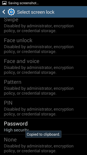

i just changed from andoird 4.2.2 to 4.4.2 but when i wanted to make pattern/password it says Disabled by Administrator encryption policy or credential storage.

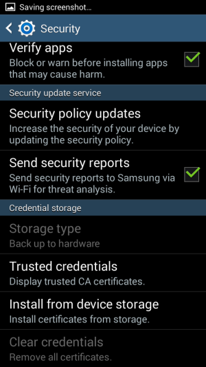

i watched some videos about cleaning credential but clean credential greyed out as you see in the screenshots.

Did you ever encrypt the phone? Or is it associated with any work accounts that might require you to have a certain kind of password?

no i didnt encrypt it also i just upgraded it from 4.2.2 to 4.4.2 then i find that i have only that problem i tried alot of ways but i still have the same problem.

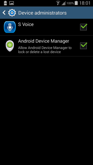

Hmm. not really sure what to try next. What happens if you uncheck Android Device Manager and S Voice temporarily in Settings>Security>Device Administrators​?
