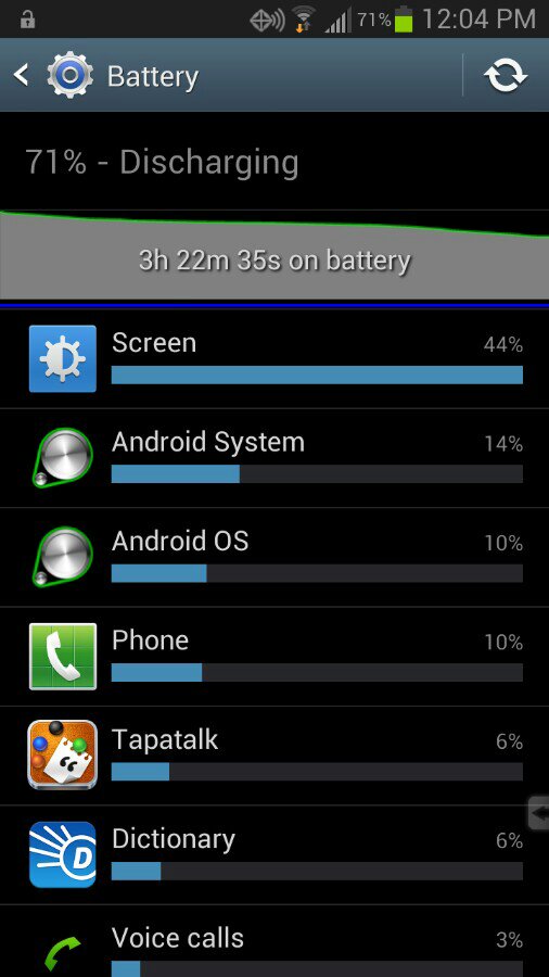

Here's a picture of my WakeLock and battery usage.

rbo18/Sailmaker,
As noted in numerous other threads, you'll need to provide more information if you want any real help. At a minimum you should provide the following three screenshots (be sure your phone was fully charged to begin with):
And unlike this data set you want to let the battery get below 40% or so.
